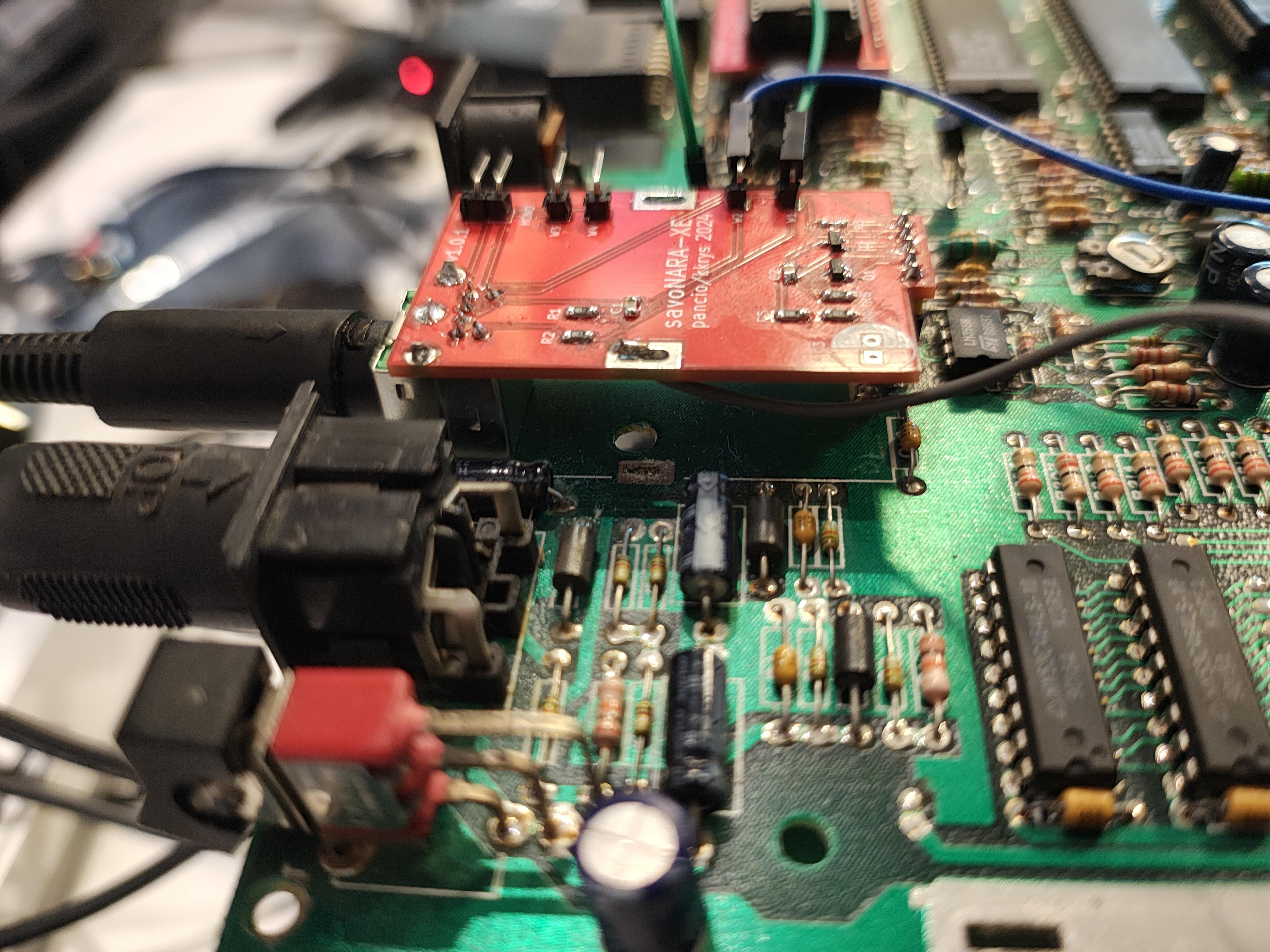

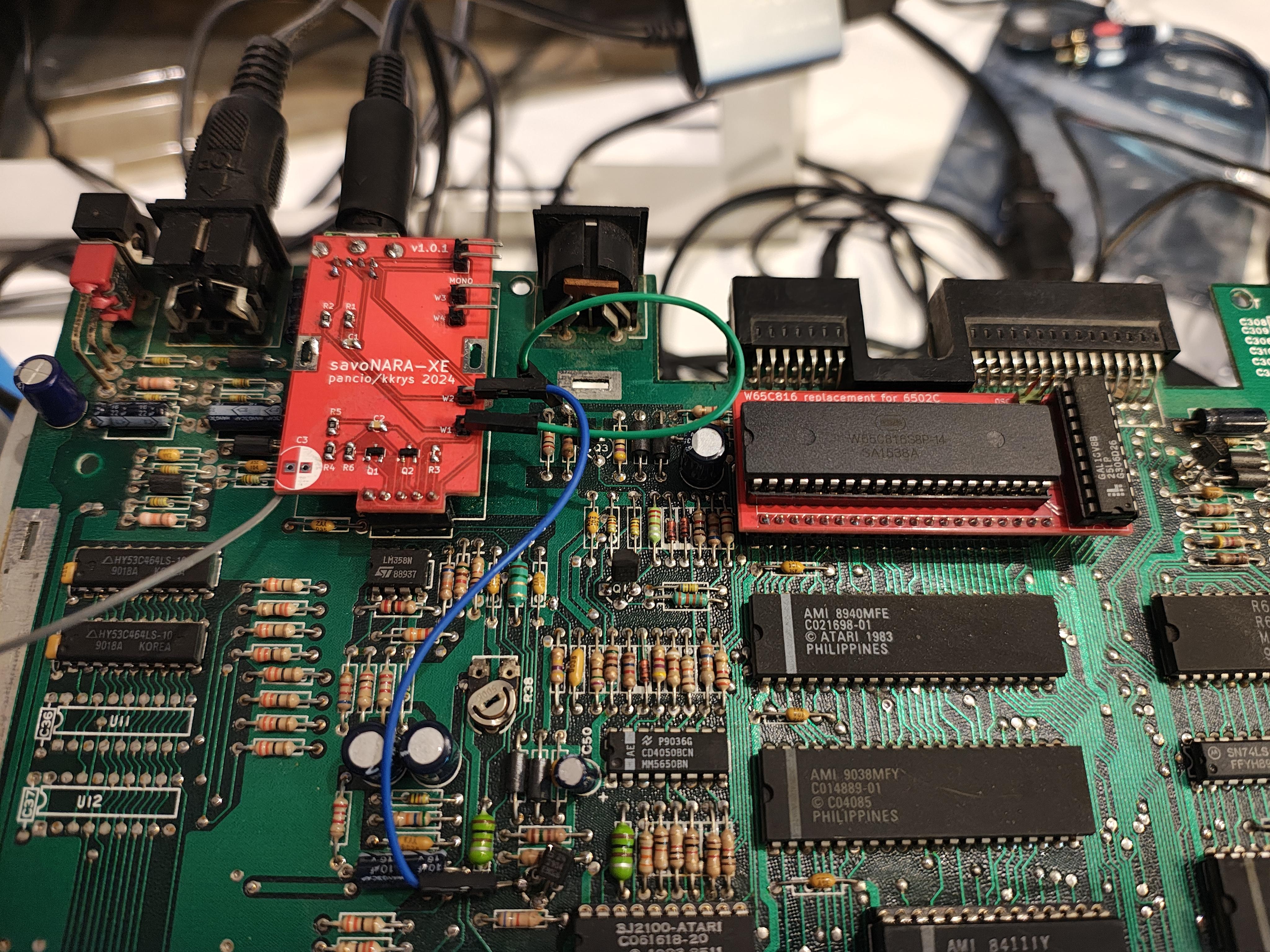

I've long break from Atari because of workload but i found a few hours to check very simple mod...
Today I managed to build and run a very simple interface that allows you to easily display the image from Atari via HDMI on any monitor/TV with stereo sound. It is a simple alternative to solutions installed in the computer such as VBXE or Sophia. It does not provide such a good image (especially as Sophia) but allows for very pleasant work and play with our Atari. For details, please visit my website.
Have FUN!

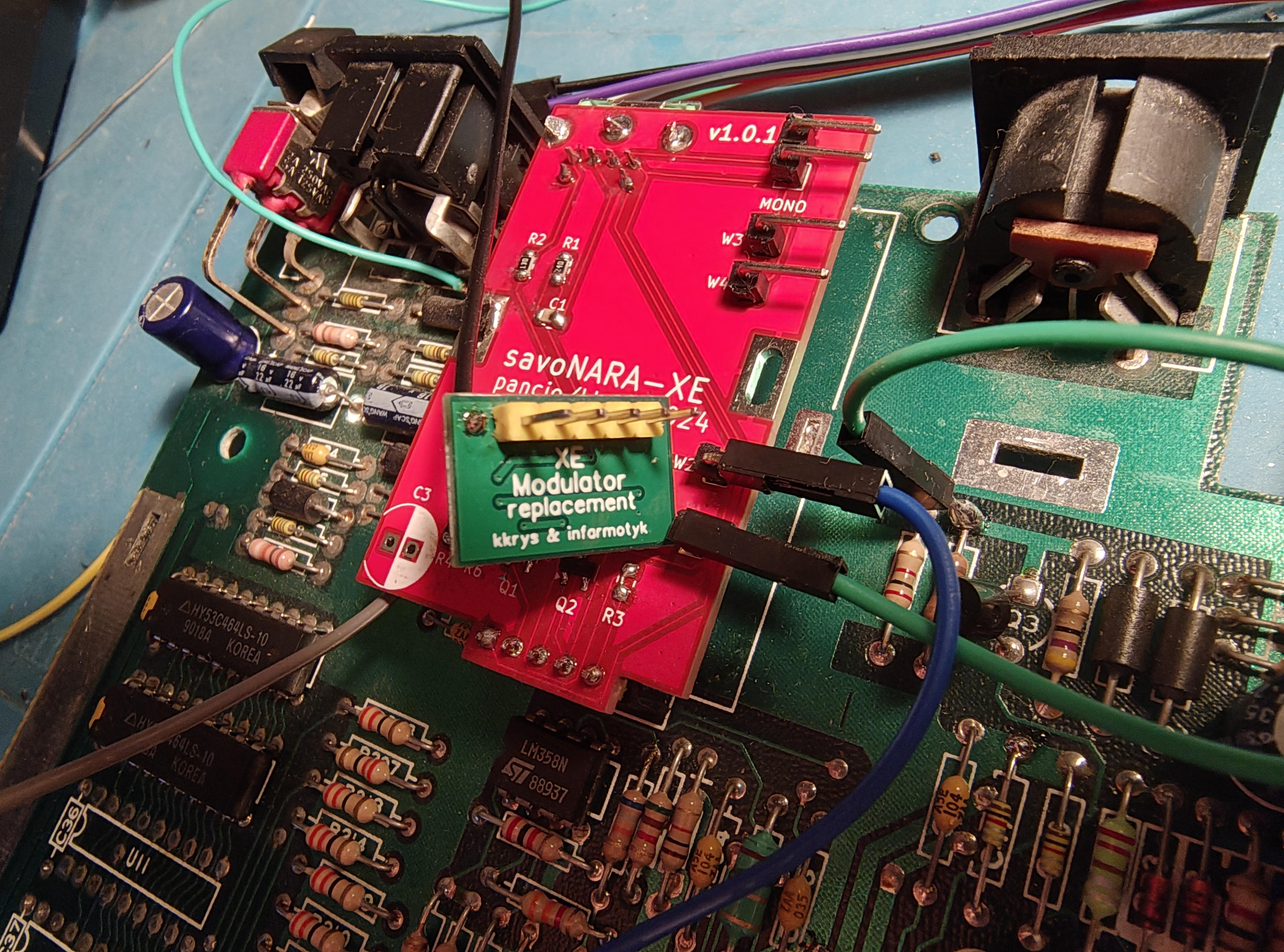

The main reason why we added additional components to PCB is reconstruction for COMPOSITE signal which is lost when modulator is drop from the Atari. So you may use standard monitor as always and use signal from miniDIN6 for ScanDoubler HDMI. Author of idea to recover COMPOSITE is my colleague KKRYS. He made easy interface called Easy Modulator Replacement in the past.

In this particular case it's replacement but PCB is prepared for "turbo" mode... We will se if it's possible to speed it up!

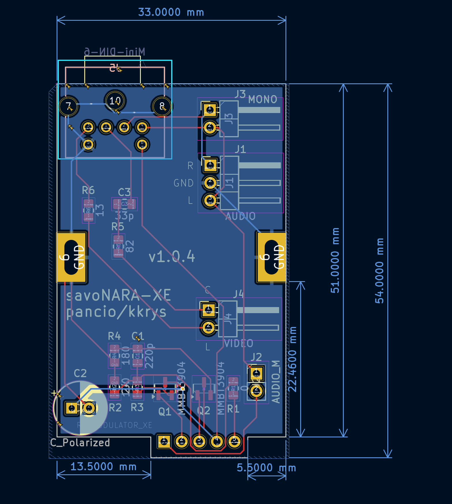

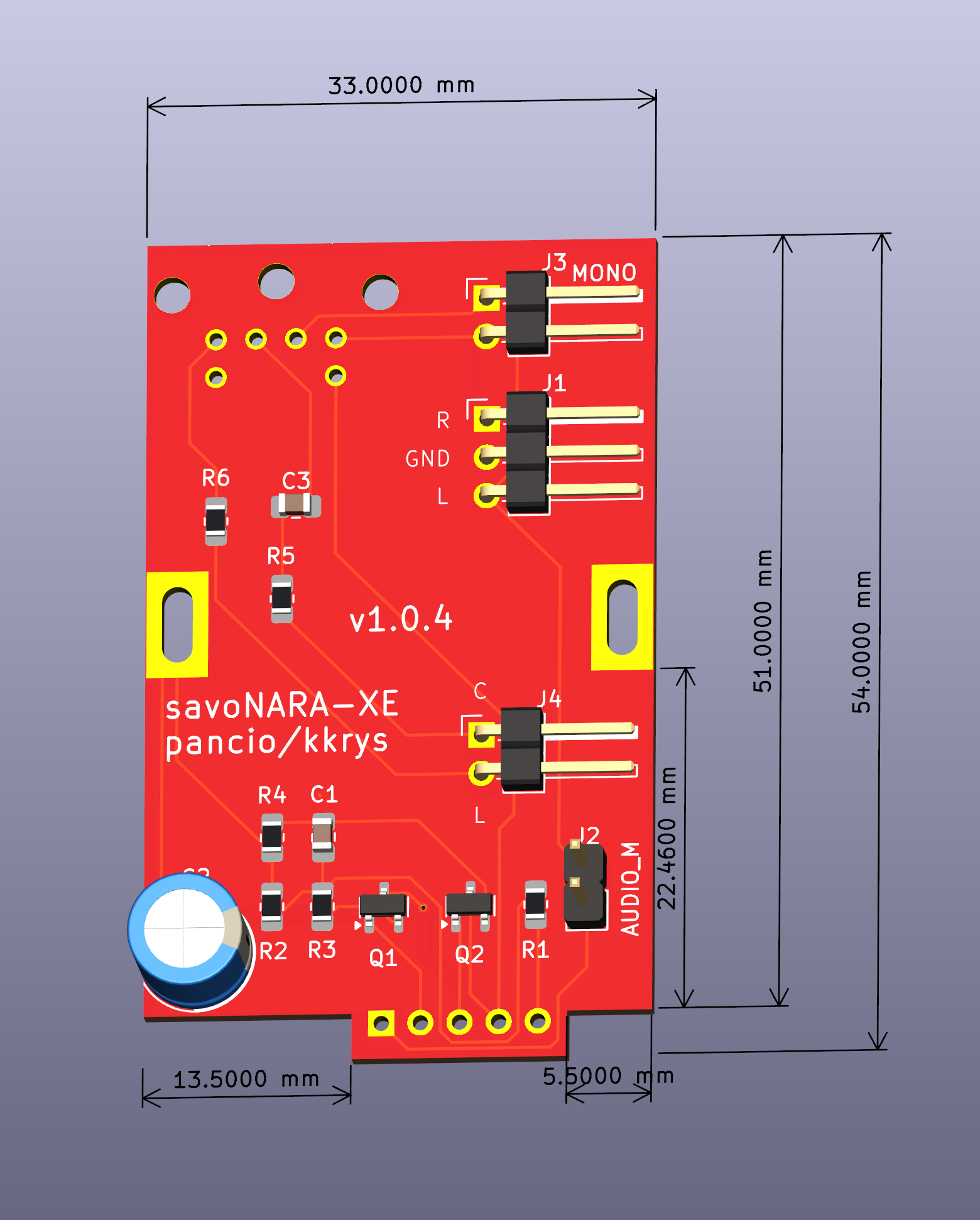

That's right. This extension only replaces the modulator but also provides LUMINANCE and CHROMINANCE signals, stereo sound and power to the Atari outside. Why? Because in this situation you can use one HDMI converter with multiple Atari - until now to get an HDMI signal (or rather VGA/DVI) you had to use an expensive device. The mod is an alternative form of a scandoubler mounted inside. https://systemembedded.eu/viewtopic.php?t=58The mod also provides power to this scandoubler.
I preferring use scandoubler inside but somebody's have more than one Atari and want to use these with HDMI - it's possible to install SavoNARA into these and use only one scandoubler. That's advantage. Nothing else... Maybe one more thing... you don't want to damage housing e.g. with bigger hole for HDMI/SCART/DVI socket.
